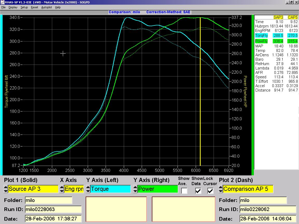

    That's right boys and girls. Our dynos ej20 record. Milo's SUPER-finicky car had a leaking recirc and now makes a REDICULOUS
    340 wlb-ft and 337 whp.
    It dynoed poorly last time, we believe due to a long learning curve (and leaky recirc) ;) On it's first pulls it was in the 290's (lower curve here) no tuning, just a few more pulls and our TMIC fan with some room temp water it made the expected 325 wlb-ft and 315 whp:

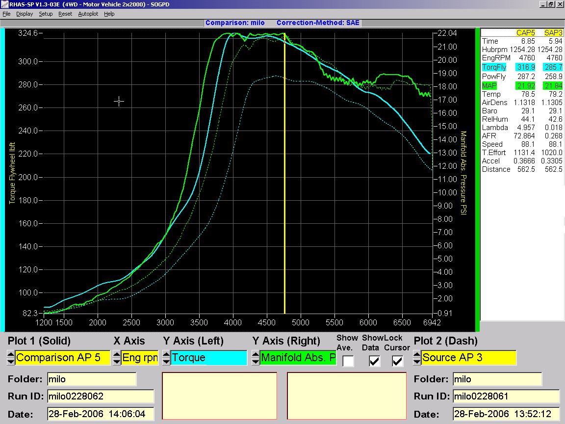

    in case anybody is wondering here is the comparison boost plot showing that the first few pulls in the 290's had the same boost as the 5th+ pull (boost in green):
    some of the "sketchiness" of the boost curve is the leaking recirc valve.
    His low map at 21 psi peak to 16.5 psi at 7k rpm makes 320+ wlb-ft and 315+ whp consistently.

    Now THOSE are the numbers I was expecting!! Very nice.
    Milo, you need a shiny FMIC now. ;-)

    Ill tell you what the doubters will say, they will say that its a dynapack. They will say that the dynapack reads high. I personally have no idea if it does.
    Those are awesome numbers milo. Get ready for a tranny.

    I'm sure Milo is much happier now that
    the leaky recirc valve has been found and
    fixed.
