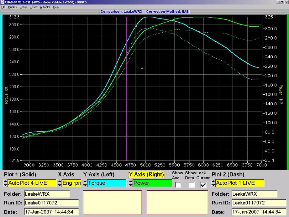

EJ205 315 wlb-ft 325 whp PUMP ONLY
Discussion in 'Modifications & DIY how-to' started by siegelracing, Jan 17, 2007.
    I was impressed (TXS FMIC, TD06H-20G (in preparation for the 2.5), modded injectors):

    Hello lag. Looks like it would be a good drag car.

    boost pressure ? and when did it hit target boost ?
    how come the torque and HP curve crosses at different location
  4. Kokopelli
    different scaling on the axis

    The car feels pretty good on the street. Remember, the stock WRX only makes 160 wlb-ft... notice how early it's got that... Again, the turbo WAS IN PREPARATION FOR THE 2.5.

    Wow, beat me to it :D
    If both HP and TQ axes were the same scaling it would cross at 5250 rpm. If you look at 5250 rpm they are the same value (on their respective axis)

    so at 3000 RPM it has 70HP+ :)

    TQ is on the left...

    Do you realize that a fully tweaked stock turbo wrx makes about 75 to 80 hp at 3000rpms. Ill take the 5 to 10 hp loss.

    Not only does a stock turbo (when tuned) crank out a lot more than 75-80 hp at 3k RPMs, it'll keep making a good bit more power until that massive 20G starts pumping.
    You're not honestly arguing that a 20G is nearly as driveable as a stock turbo on 2.0 engine are you?

    Stock turbos go 13.0 to 13.5. This should go LOW 12's as-is, and with some race gas should have no problem running solid 11's. The owner IS a drag-racer, and is preparing for the 2.5. With the 2.5, the 20G will be on the small side.

    I'll post some 1/4 times when I can get to the track, but this is not a daily driver for me- lag was never an issue. It's really not as noticeable as you might think.

    Even with a TD06 housing? That is the only scary part to me at this point....having to wait an extra 1000 rpm+ for boost to set in. The 2.0 kind of falls on it's face before boost sets in.

  38. Ah, it all makes sense now. That late spool up time is because of the td06 exhaust wheel. :slap: I should have paid more attention in class... Which is why its in prep for a 2.5.
    If anyone wants to run a 20g on the stock 2.0 block, get a td05 exhaust wheel, not a td06.
    With good tuning, a td05 20g spools up by 3500rpm on a stock 2.0 block. I've got a nazi-socks link here somewhere...
