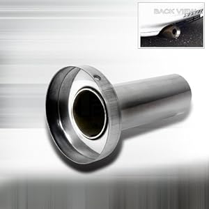

  23. nuyorican718
    nuyorican718 Member
  24. Trancetto

  26. superhawk28
    superhawk28 Member
    Not accurate.....I lost 15 hp on the dyno with a tip silencer installed.
  27. Trancetto
    Which is why I'm going with a cutout.
    I can keep it closed/open to my choosing.
    I had a straight pipe on my wrx, which is very close to the cutout I plan to run. Thing was LOUD!!
  28. nuyorican718
    nuyorican718 Member
    No DETRIMENTAL losses. 15hp Can be from dirty filters, old oil, ambient temperature, false readings changing your timing, the dyno itself, boost. Although you lost 15hp you shouldve gained some tq out of it.
  29. superhawk28
    superhawk28 Member
    Back to back pulls on the dyno so 15 HP is detrimental. Wow a whopping 1.7 more tq.
