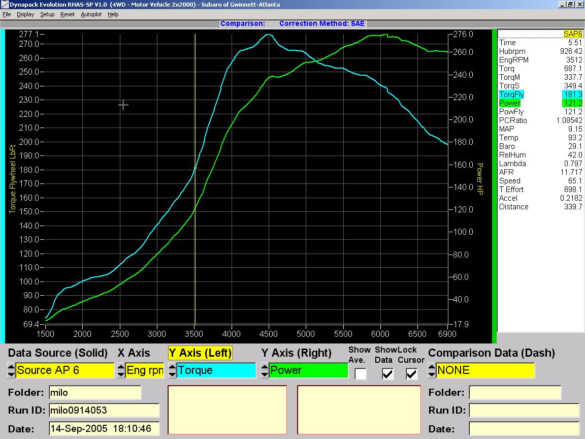

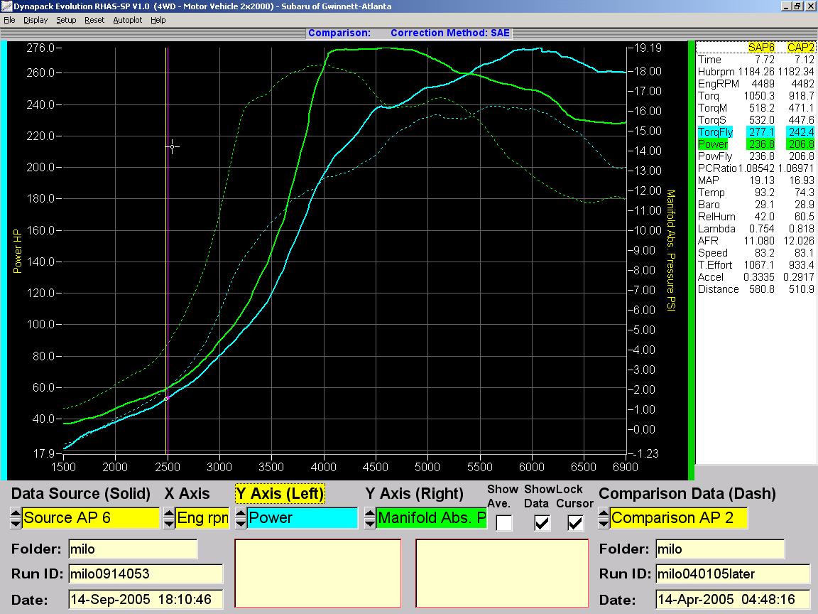

    here's a summary of what happened today:
    we slapped it on the dyno first cuz scott wanted to get pretty plots... he said a smooth tune on the road will have a lot of wiggles on a dynapak... after a bunch of pulls he got it smooth and started adding power... however, at the end of it, the engine bay was so heat soaked that it didn't want to run much timing at all... the best we managed to pull on the dyno was the 276/277 run u see above... also note the boost peaking at under 19.2 and tapering to about 15.5 at redline

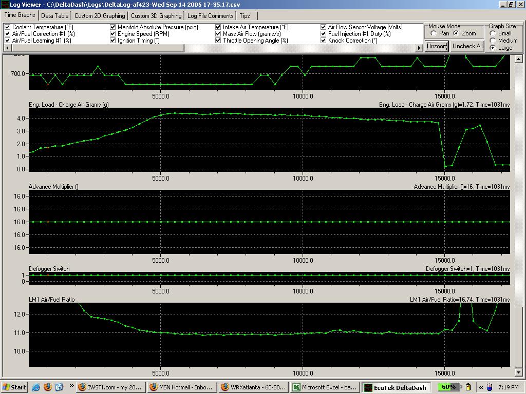

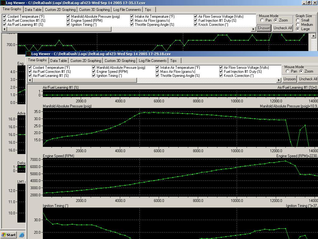

    here are some logs after the last run on the road
  19. moose
    Looks like you're hitting full boost around 3700-3800 RPM. Sound about right to you?
    A/F ratios look suh-weet. Just a hair under 11:1.
  20. miloman
    yup... ur right :)

    nice numbers milo. i guess if kris's vf22 does 260 then 276 for the 16g is nice. i was thinking it was goin to be way closer to 300hp if not a lil more. bambooi put down better numbers on a stock tmic and a vf22 than both of you guys. milo im glad your happy. sorry bout the lil rant.
  32. slowwrx
    Good numbers, thats about what you should expect out of a 16g, quick spool and fairly solid boost all the way to redline.
  33. miloman
    bambooi put down 274/270 with a vf22 and a stock topmount
    kris put down 260 with a vf22, stock top mount and an uppipe leak
    i put down 276/277 on the dyno but on the road we got it to run a pound more boost and an additional degree of timing across the board... unfortunately didn't get to dyno it again after that
    either way theres no point comparing dyno numbers on cars that have been dyno'd at different places on different days...
