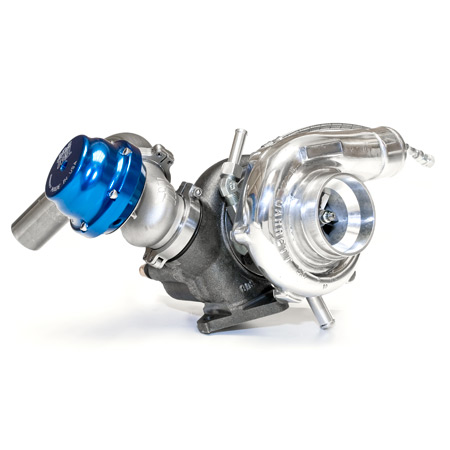

    Any experience with these turbos? Rotated is out of the question since he has EVERYTHING else ready including the WG.
    GT3076R Subaru WRX/STI Bolt-on Stock Location Kit - Externally Gated
    They seem to be working very well on IWSTI but I want to know if Topspeed has tuned one of these.
  2. Doug@DBW Motorsports
    Doug@DBW Motorsports Active Member
    hahahahahhaah ahhh no.
  3. Cool_____
    HUH? Are you saying no you haven't tuned one?
  4. Doug@DBW Motorsports
    No I am saying I have and it sucked really bad
  5. Cool_____
    Thanks. Can you elaborate what sucked so bad? I need to explain this to my hard headed friend.
  6. Doug@DBW Motorsports
    Didn't make much power, and was laggy.
  7. Doug@DBW Motorsports
    Oh then two weeks later it broke... IIRC aren't those the china made turbo's.
  8. integroid
    God I hope not. These are made by ATP and are suppose to be a Garrett center section. I have heard they had problems with the wastegate design and not being able to make boost.
  9. Doug@DBW Motorsports
    Last time I was checking international companies those were made in china. Atleast at PRI and SEMA it was all the china ebay companies selling them. I just checked online and it appears they are no longer selling them so maybe ATP bought the rights to sell them in the USA. But originally they were China built crap.
  10. Cool_____
    Did the one you tuned have the EWG mounted on the exhaust housing?
  11. Cool_____
    Here is a 91 octane tune done by YimiSport....
    Yes it's laggy but it is a stock location.
  12. integroid
    Wow, not very impressive. You can get a rotated kit for a little more that will make a lot more HP. I have seen green setups make about that on pump gas.
