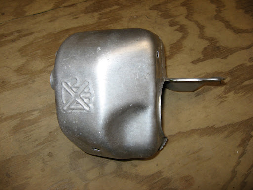

    Do you have a heatshield on the turbo? If not, I bet $10 your power steering line touched your turbo :bigthumb:

    well i have 158000 miles i do have the heat shield and i dont think its my power steering because it still works fine i can replace the turbo with a td04 for 125 dollars and what else would i need like gaskets or lines?
