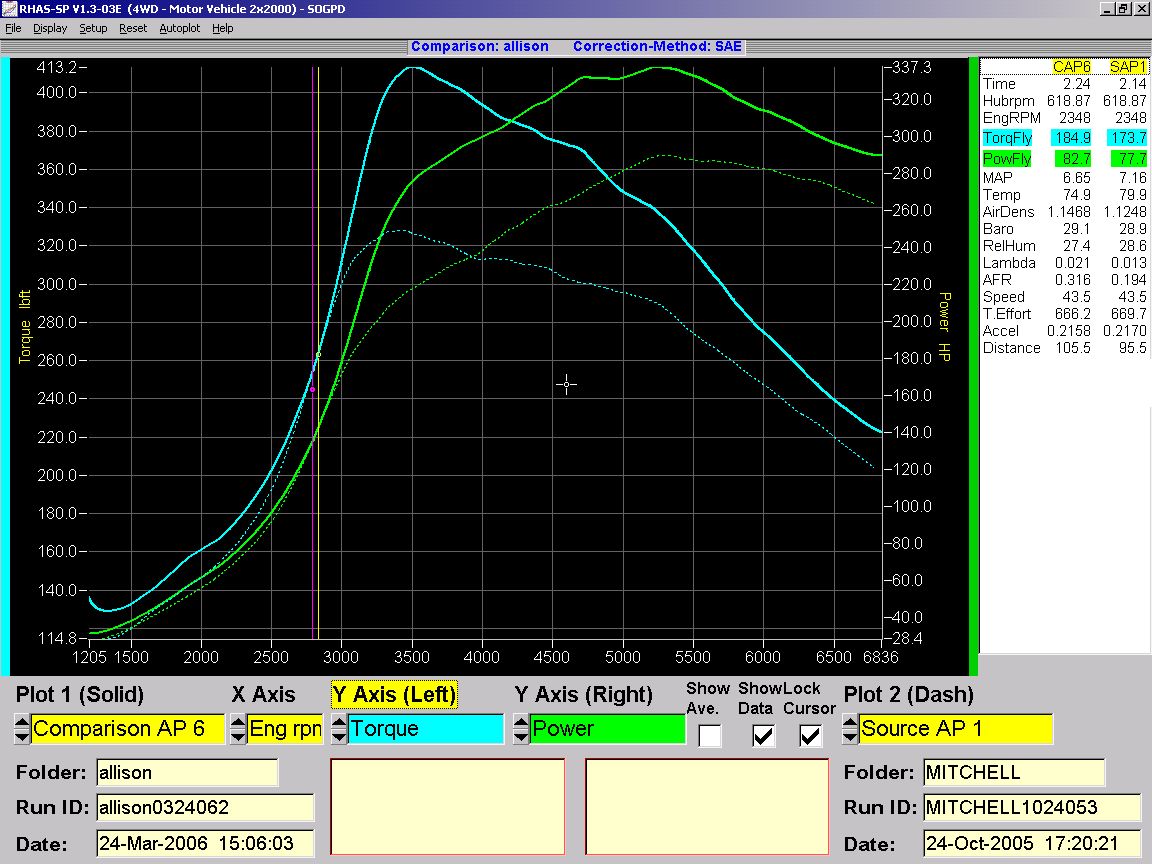

    as for as the power gains on my sti......
    TBE, EBCS, Ecutek = 291whp, 334 wtq
    +meth and big tmic = 337 whp, 413wtq
    U do the math, it was worth every penny. the car was brand new to me after that day
