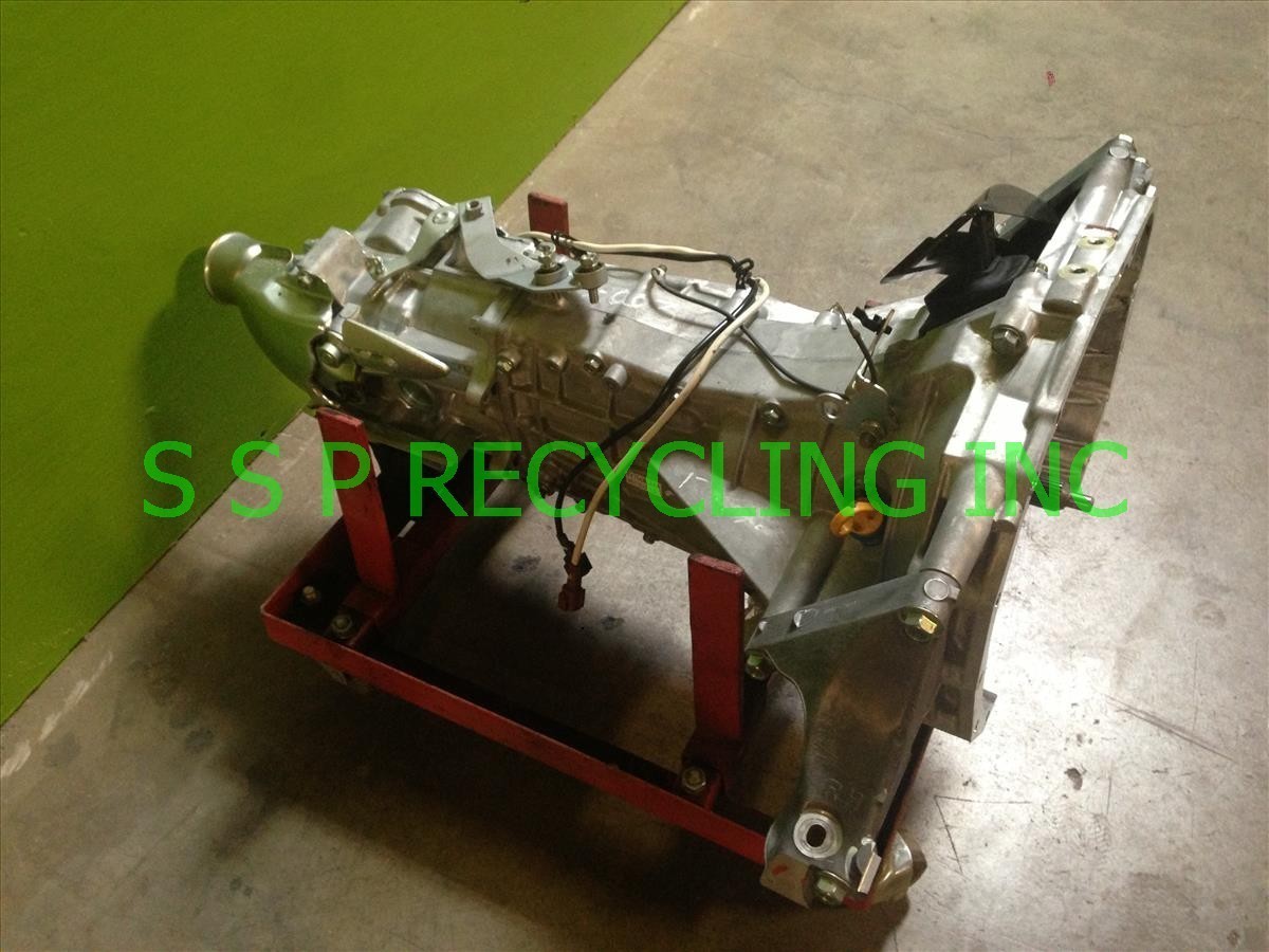

Not to hi jack your thread but bringing this up out of curiosity. I know having the sti 6 spd is what everyone does and you have to change a lot out. granted the 6 spd is an awesome transmission. I got curious as I recently put another 5 spd in mine to get my car back on the road. Anyone know if you have to change everything still for a split case 6 spd? I'm mainly looking to get a 6spd and some mpg back haha. with just a 2.5I no turbo or anything here
proof http://i.ebayimg.com/t/10-11-Subaru-Legacy-6-Speed-Manual-Transmission-Gearbox-tranny-57K-6MW-non-turbo-/00/s/OTAwWDEyMDA=/z/4e8AAOxypNtSgBI5/$_57.JPG
the split case 6 speeds are coming in the new wrx and were in the 2010 LGT's they hold up.. just not like an STI trans. I'm pushing like 150hp I think a split case 6 speed would do me just fine.

Why bother.... If its really a 5 speed box that they crammed another gear in Ill pass for sure. Just means its even weaker than before.
