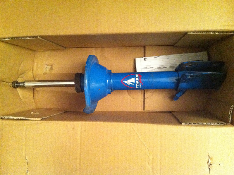

    Tokico Blue Shocks for rear (good)
    Stock Shocks (blown)
    STI seats, carpets, and door cards. Also STI knob, boot, and boot trim.

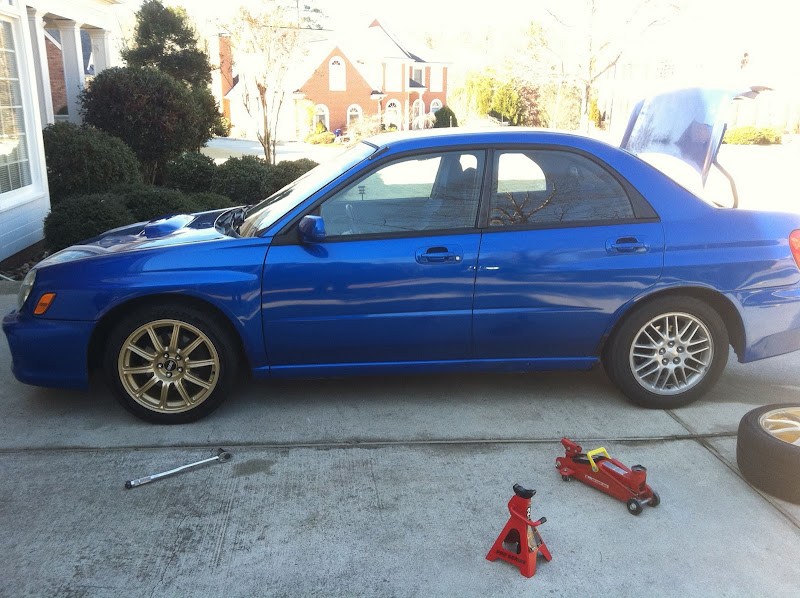

    Second mod, was getting ATLxPAT’s old BBS rim and tires. The falken that came with the Legacy wheels was already well worn with only few months of rubber left, so I figured I can spring for the gold BBS locally.
    At this point, my buddy is far more excited and mod-happy with my car than I was, and egged me to get a new exhaust for the car. He had spammed me with FS links every day, and found a Cobb full TBE setup for good discount. We started taking things out…

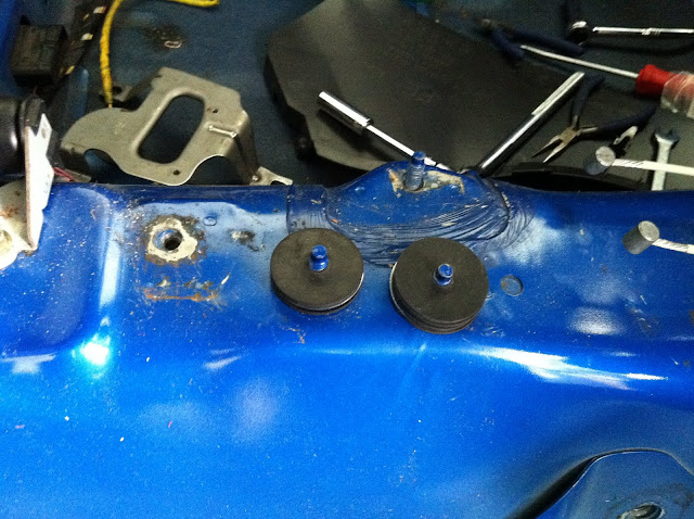

    This is when we found out that my car was missing some interesting pieces… such as:
    Intercooler bracket
    Heatshield + bracket
    BCS cover
    These things would have been obvious when I looked at the car, but my inexperience combined with excitement of finally getting a Subie, I had not noticed these missing things. I fully expect to find more missing parts and spend “mod” money on putting the car back together with stock parts.

    First is, my WRX apparently came with a security/immobilizer unit underneath the console box
    I had no idea about this thing, and haven’t really run across it in any console swap threads. This box won’t fit inside the new console, since the new-style E-brake does not have space for it at all. We decided to tuck it above my SRS ECU box with some foam padding to keep it from clunking.
    Next issue is that, the new-style E-brake doesn’t line up well with the chassis, and many have suggested in the guides that you should “bend” the handle to proper angle. We thought there has to be a better solution… So we crafted a washer solution to it. Basically you buy some steel and rubber washer at your local hardware store and raise the assembly to a proper angle. The washer amount in the picture was overkill, we ended up using much less for good alignment. We figured out the “right” amount by trial and error. The rubber will help with any metal noise and they’re easier to compress.
    (Please note we used a different height than what is shown here, and we also shimmed the tripod's right front leg with 1 washer to the ebrake/chassis [top stud in the picture below] to ensure the tripod was as horizontal as possible for the console, while the ebrake was vertical "enough" to clear the console)
    We also rigged a nut/bolt to connect the lower bracket with the e-brake handle.
