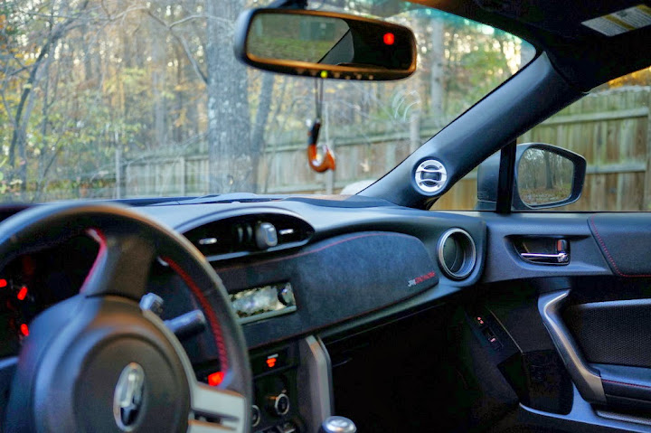

    New tweeters / pillars

  5. J_P
    Beautiful car. That deck is amazing. Any regrets or complaints about it?
    And you can NEVER go wrong with some JPM finery.
