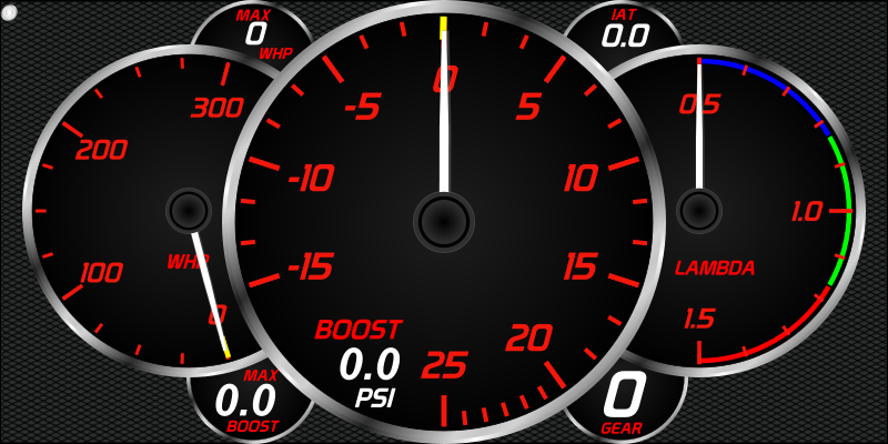

    Anybody running a carputer to drive gauges via OBD2 links on a touchscreen? Put in a 7" touch screen, a carputer and run Palmer Performance software (DashCommand/ScanXL) and you can design a custom gauge set.
    I love this custom DashCommand screen.
    http://www.dashxl.net/screenshots/47.png
    I would probably run wideband AFR/boost/oil pressure/oil temp/coolant temp, but this is what is possible with the Palmer software running on a carPC, so you get the idea.

    motomark Loudest fuel pump Tucker Supporting Member
    That 5 gauge cluster in a 7" screen is pretty much exactly what I had in mind. Thanks for posting that link.
