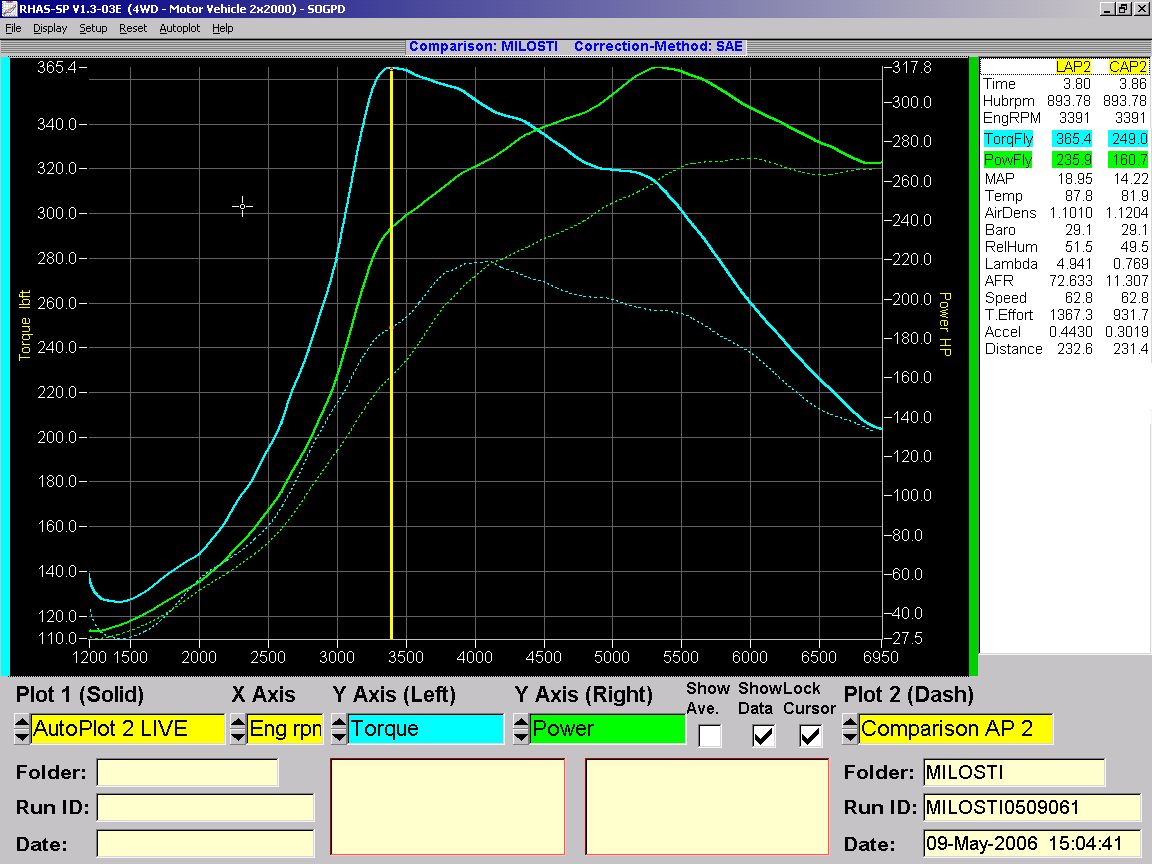

    Sorry this has taken so long. I've gone to post it like 5 times today, and I made ALL the comparison plots this morning, but I've had over 40 (FORTY!) phone calls today (I have 11 messages left...) I'm going to post this before I leave.

    holy shiat milo, those are some AWSOME numbers! look what little it took to break 300hp.

    Awesome number Milo. I want to break that damn 300whp. hahaha
    I envy you man. That 365wtq is a pure shearing torque!!!

    the off boost torque is definitely nicer due to the added displacement on the STi
    compare it to the WRX dyno: http://www.wrxatlanta.com/forums/showthread.php?t=5260
    STi: 365 wtq (~3400 rpm), 318 whp (~5300 rpm)
    WRX: 340 wtq (~4100 rpm), 337 whp (~5600-6300 rpm)
    so the STi has literally, no top end power at all... in the STi, the power comes on hard and dies out above 5500 rpm... the WRX came on smoother but ripped all the way to redline... then again, the WRX had meth and a bigger turbo
    now what turbo do i want on the STi :D
