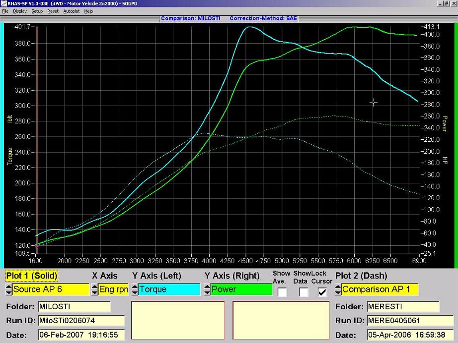

    The car is safely a 395 wlb-ft and 405 whp all-day, every-day type setup. To see what it would run when pushed a bit, we got this: (drum-roll please ;) )
    Again you can see driveability must just be terrible. ;) It's so much less torquey than a stock STi down low... :D

    yeah.... that turbo must suck.
    Looks great guys. 400whp on pump with no meth is awesome.

    the pull is simply amazing... we dropped 2psi from the dyno pull shown for street use and it still feels amazing
    im tempted to go high octane :D
